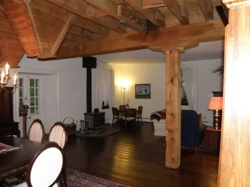

    Even a pipe up thru a second floor room can work. Here's a house we were looking at before we bought our current place. 6400 sq.ft., very high-end restoration of a 1740's mill, so we ain't exactly talking trailer park, here.
    Unfortunately, I searched my collection of photos on this house, and could not find an actual photo of the pipe going thru the master bedroom. It was simply a brightly polished section of double or triple wall pipe, no chase, but nicely finished with floor and ceiling flanges. Probably gave off a little heat into the bedroom, when the stove was cranking.
    This place was 4 stories, so it was one heck of a run of pipe! The soffets / gutters were 53 feet above the lawn, according to the people who had done the roof.

    Joyful that is a nice looking room. That house must have been sweet. The flanges are a great idea.

    Looks really nice, But the pipe will be in the middle of the room. I can't change the room anyway to get a straight run. So it looks like it will have to be a 90 to the thimble to the tee then up 18 ft and hope for the best. I know I will really have to heat up the chimney before I get a fire going.
