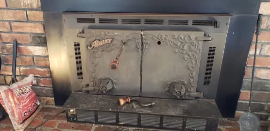

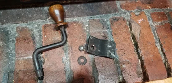

The handle broke on my Ashley insert. The handle that locks both doors. I can't find any info. I need a replacement handle. Any help would be appreciated. Thanks

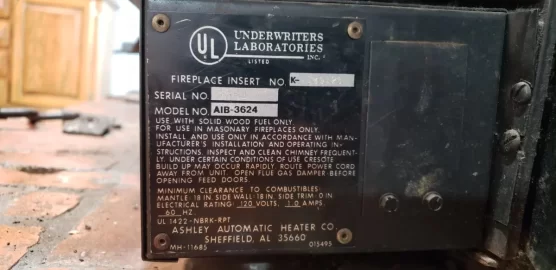

Model number: AIB-3624
Serial number: 3881
Insert number: k-149125

That's an old fella. Parts are unlikely to be available, something will need to be fabricated. This looks like a simple assembly. Maybe a short threaded section could be welded on to replace the part that broke off.

Yeah, take the other handle off if it's the same design - as long as the nut isn't seized on it, and take it to a welding fabricator and he could knock you something out right quick.
