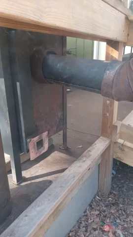

post a pic of yours where the blower mounts
Does it bolt into a heat shield or the heavy plate of the stove? If it’s the heat shield, you may need to drill some mounting holes.
Hi Matt! Thanks for the reply. Mine mounts on the rear lower left. It's a square opening, the gasket is there and there are holes for bolts. I have the original fan, but it's kaput! There are NO numbers on it anywhere! I'll take pics tomorrow and attempt to post. Thanks again for your input. Jim

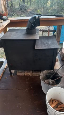

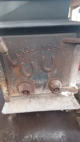

I (almost) forgot to post pics of my stove/heater as promised. I once had what could be describe as 'healthy brain matter'. But now 'scar tissue' best fits! Capish
I will attempt to post 3 pics in hopes someone out there has less 'upper scar tissue' than I and can help me to locate the correct, or suitable, fan blower. As you can see on the rear lower left there are 4 places for bolts. The second pic shows the heat exhaust to be well forward on the second level. I found a similar stove but this 'outlet' was located more on the rear of the second level.

Can you measure up the bolt holes and size of that outlet? I think there are several after market options.
View attachment 343867View attachment 343868View attachment 343869
