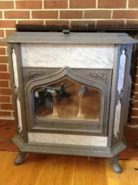

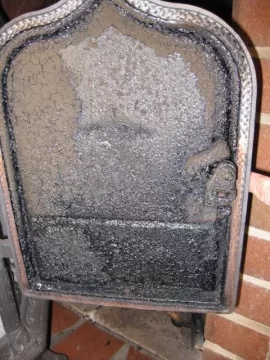

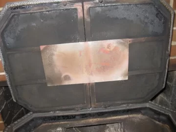

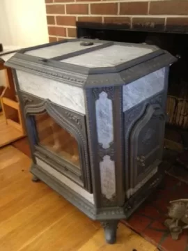

Any help / info would be greatly appreciated. I'm looking at this used Woodstock fireview... asking $1800 , offered $1250 he countered with $1600. Also I will be driving 6 hours to pick up, South Carolina to Virginia.
I ask for lots of pics because of the drive!!! Please take a look
pics

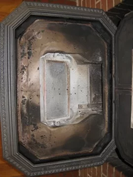

Just posted pic of cat

Looking at pics does everything look OK? Gaskets ....Cat...etc???
Told it was only a couple of years old
How do I tell?
New the stove is on sale for $2545 at the moment. And you get a tax credit with a new stove. Sure wouldn't pay $1800 used, plus a new cat (have to assume you'll need one) plus the cost of your drive. Chances are pretty good they got the stove on sale and have used It for a few years.
On the other hand, the stove looks in good shape.
I'd offer $1400. That way, with a new cat and the cost of getting the stove, you aren't far off what you'd pay Woodstock for a warranteed rebuilt stove which would have a new cat.
Reactions: alforit
Looks to be in pretty decent shape from what I can tell. It has the older steel cat that had a few problems but that can be replaced for $125 if it's not working. The $1600 may seem a little high but I've seen them go for that around here. Long trip to pay that much if it were me, I think I'd counter about $1400.

That's a beautiful looking stove. Well worth the drive. And they remain super nice. Great company, service, and stoves. Good luck, I hope it works out.

I think they started using the one pictured 3-4 years ago, they were ceramic before that. Last year they made improvements to the wash coating and changed the construction from the wound crushed steel in a cast iron frame to a more uniformed layered steel cat in a steel frame. If you go into their web store you can click replacement cats and take a look and see the difference.
I think it was 3 years ago on the steel cats. Update: they now have some newer steel cats that should be even much better. The new ones come with their own frame so changing them out is super easy.
On that Fireview, it looks nice on the exterior but needs some work on the interior. New cat, fire bricks and lots of gaskets. Personally, I would not go above your original offer but probably would have started the offer at $1,000. When you consider the distance you have to go to pick up this stove and the work involved in getting it ready to burn, you will have many dollars tied up and it will still be a used stove.

One more thing: if you do buy that, remove the cat before moving the stove, lest it come out and roll around in there. New from the factory they come bolted in but most folks throw the shipping bolts away the first time they remove the cat for cleaning. That stove does not have the shipping bolts in place.
