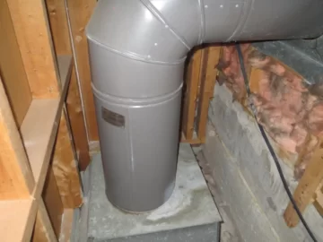

Sorry, late to the party on this one, but I am in a very similar situation with the same model of fireplace (Selkirk 832) and same location (Ottawa), so don't see the point in starting a new thread.
We bought or house about 6 years ago, it was built in about 1970 and I am guessing that the fireplace and chimney are original or close to it. We have never used the fireplace as the chimney was pretty rusted out when we bought the place. I originally bought a stainless steel chimney second hand, but in good shape, planning to replace the existing one, but never got around to it. Now the wife is compaining that the basement, where the fireplace is located, is too drafty in the winter. Like many of you, we had a long and hard winter this past year, so now we are looking for options to replace the fireplace and/or chimney. Our options include an insert (wood or natural gas), a new fireplace install or possibly just replace the chimney.
Of course, every company we contact recommends removal and new install, but that is $5-10k and it will be impossible to match the brickwork with the rest of the basement. You can see from the attached pictures, most of our basement is brick, including the fireplace. When we moved in, we painted the bricks and installed new floors, so I don't want to go messing with a new install now if we can avoid it.
Any advice would be appreciated.
View attachment 135455 View attachment 135456

The 832 was never approved for:
- glass doors – not even aftermarket glass doors; as seen on this unit
- 90° Tee out thru wall – was listed with 15 or 30 degrees elbows only
You cannot install a gas fireplace insert in this model.
Suggest you remove and install a New Direct vent gas fireplace complete.
Good luck , Hope this helps!
Reactions: DouggyD
Great, thanks for the reply Kimmy! I have had similar feedback from 2 other companies today. Not what I want to hear, but what can you do.

OK guys, small update for you. The insert recommended by one company was the Enviro E20, but the firebox/glass on that unit is only about 21"x12" and the hole for the current fireplace is about 37"x26", so I think that particular insert will look really tiny in the space. Most companies I contacted are recommending that we tear out the old and install a new direct vent gas fireplace, as most of you had also recommended. However, I do want to keep the existing brick as itmatches the rest of the basesment. We also re-did the floor there recently and don't want to get into re-doing that either. I am proposing to take out the old firebox and chimney out the wall to the right of the fireplace (see attached), and then insert the new gas unit behind the brick. The models I am looking at now are the Regency Horizon or Panorama (HZ33CE or P33CE). These models are about 29"x21", so much bigger than the E20 insert, but still a little bit small for the hole. The height seems to be the limiting factor,as the hole in the brick seems to be a bit of an odd size. Are there any other models that you could think of that would come closer to filling the hole (37"x26").
