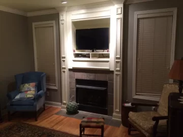

Before

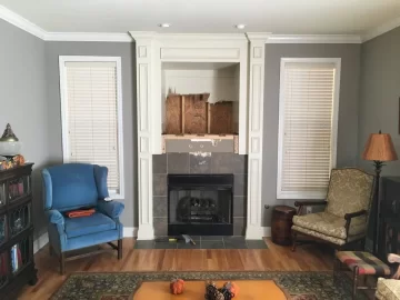

Started to demo here, we have to relocate the power and cable before the installers come to pop the flue in.
