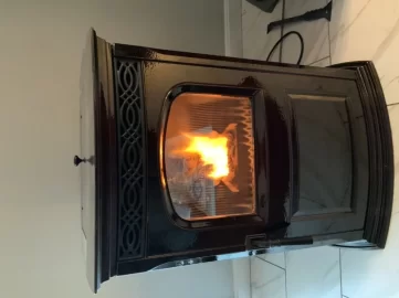

Don’t forget that pellets play a major part in maintenance as well. I have a Harman Accentra for easy maintenance and a large ash pan. I burn Northern Warmth Supreme Douglas Firs and find my weekly schedule has been reduced to every 3-4 weeks. I scrape the pot while running every day or two, shut her down every week or 2 and scrape the pot, clean the glass and hit the exchanger with a quick brush/vac (takes 3 minutes). [Hearth.com] help selecting a pellet stove with reasonable low maintenance requirementsHere’s a picture one week after a fast clean.
