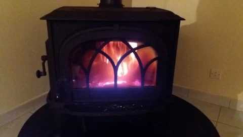

Do you put the wood at the right and left side of the stove, like on the video ? because we ordered 18 inch pieces and they will be too big for that.
As for the fire, we are starting to get depressed :D Tonight we burnt 4 large pieces of wood, and it is still cold in the room. The temperature didn't change in the room! After 1 hour of burning the temperature rose to 400, we closed the air a bit, it started to go down after that.
We put two wood pieces parralel to the window. With lots of little pieces of wood, the kindling, between the two, some paper. It was burning really nicely, but the temperature did not go up. After some time we added the third wood, which made the temperature rise to 400 (this was one hour after we started the fire). We closed the air and that is when the temperature went down.
Should we start with with 4 medium wood? Do you put as much as on the video?

400ºF is cool for this stove. With a full load of good dry wood (this is important) the stove top temperature should be around 600ºF. If the draft is weak or the wood not fully dry inside, then there will be poorer heating performance.
Is your wood moisture level from the middle of a freshly split piece? ( you mentioned having to buy wood)
Sounds like certainly could be your wood. Try some (1 or 2) ecobricks.

I simply load in newspaper and a crumpled grocery bag...then load in 18 inch long pieces of very dry kindling....(criss cross it..make so the air can get to it), mostly hardwood kindling...but softwood burns quicker...must be very dry...put enough in to create a good bed of coals (Yes as much as the video...I do not use large pieces to start like the video shows). Let it burn down into coals...then load medium fire wood on top...load several pieces so air can weave into them...make sure the air control is open all the way and be ready in a few minutes to shut it down a bit...quarter at a time. Once a nice bed of coals forms, you can use the larger pieces. Dry firewood is a must...two seasons on the hardwood. I keep my wood stored in a wood shed...4 cords it will hold. 4 more on stand by under a tarp...then I shift that into the wood shed in the spring when there's room.
