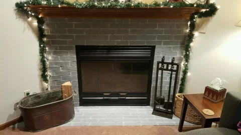

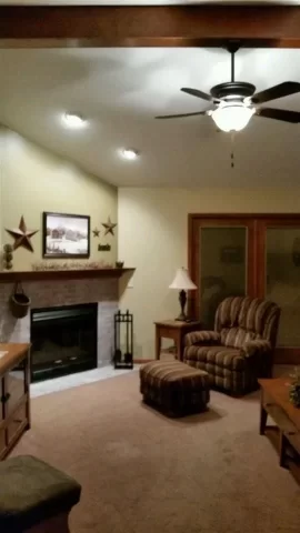

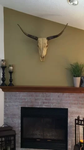

Hello all,
I am newer to the fireplace heating world. We purchased our home about 1.5 years ago and there is a Majestic SC36 fireplace in the corner. I am was wanting to upgrade to an EPA ZC Fireplace, but I am running into issues I believe. The current fireplace is small and doesn't take up much room. The newer EPA ZC fireplaces are much bigger and take up a whole lot more room. I would have to bring my corner wall out into the living space over 12-15" for the EPA ZC fireplace. Is there anything that has similar measurements of the Majestic SC36? What would be other suggestions besides moving the wall? My wife doesn't like the idea of making the living space smaller. Also, she doesn't really like the idea of a free standing wood stove as she likes her fireplace mantle and décor up and around. I would really like to make this more efficient. Thanks.

Pictures help if you can put them up.
Have you sized up the Kozy Z42? It has a pretty small foot print. We replaced several old fireplaces with this model and it was a good fit.
Here are a couple older pics. The width of the wall is around 68", which means the 2 side walls are roughly around 48" deep.

A 3" change in depth would be barely noticeable once it's all finished. There are ZC fireplaces that are only a couple inches deeper. Could it be that she is resisting on other grounds like cost, impact (dust and short term mess) or final look?

How do you figure 3" in change? My zc is triangle and has different requirements. Most of the epa's are square or rectangle and have to have wider clearances.
It was just a guess without the dimensions of the corner space. I just took a look at the manual for the SC36 and see what you mean now. There are some smaller 2 cu ft fireplaces that are around 36" wide and 24" deep like the RSF Focus 250.
