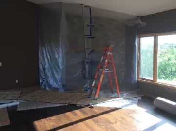

So had to make big decision on whether to take down existing wall and take out the ZC. In the mean time I started working on my wood pile. I learned I needed the time to get some dry stacks.
Fast forward to May of this year an finally decided to take the leap. Had a newer wood floor so I decided to let the pros take it out vs me doing it and making a mess.
I bought the Quadrafire Explorer III. from Fireside in Eagan, MN
Why the Explorer? Well first off was wife had to like it. This is in our living room. She loved this look.I wanted something with a decent efficiency. The Explorer III is rated 2.0 grams /hr. I also wanted easy loading and the top loading was a benefit. It also will take big splits. 22 inches though it really recommends 18's.

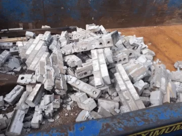

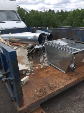

So the demo began.
[Hearth.com] My journey from Zero Clearance to freestanding wood stove.

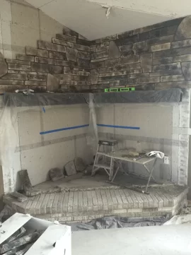

Kept the existing hearth and decided to stone over that. Picked our mantle from Twisted Knot. These are reclaimed timbers.
Nate showing the hard work involved and some free advertising.

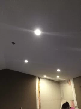

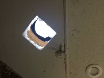

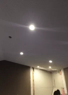

Added lighting and a ceiling fan

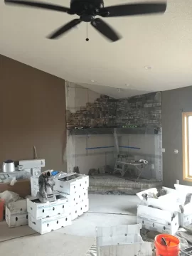

Next was the stone work.
You can see old hearth was just stoned over.

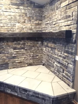

Turned out great! Room feels much bigger.
