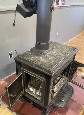

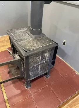

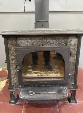

I am wondering if anyone can help me figure out what kind of Hearthstone stove this is. The seller is asking $350 or best offer. She just moved into the home and doesn't want the stove. She tells me that the folks she bought the house from told her that they maintained the stove well, cleaned it yearly etc. Looks pretty used which is ok I guess. Is it a good deal? I really want a wood stove, my house is so cold and after almost 2 years practically alone, not looking forward to a cold ass winter. Any help would be appreciated. Also, any idea what the electrical plug is for? Thanks

Looks like a Mansfield. The plug appears to be hanging off of a draft booster fan. This may have been installed in a negative pressure zone with troublesome draft.
Thanks, do you think $350 is appropriate? and do you know what the thing hanging off the pipe with the cord is? I have some homework to do re:pick up /install, Just trying to figure out if it's a good deal before I commit. Thanks for responding

If the stove is in good operating condition that is a great price. If that is a draft booster on the stovepipe then you most likely will not need it. Tell us more about your house size and where you want to install it. How large an area will the stove be heating? How open is the floorplan? How many stories?
The biggest issue at this late date will be getting truly dry, well-seasoned firewood.

Looks like an older model Heritage. Looks to be in pretty decent shape, great deal for $350.

does the 1990, age of 31 years old still fall in the category of a great deal Todd?
Did you receive any pics of the firebox? I don’t know much about this stove but if the insides look ok like the outside I’d say yes it’s a good deal.

I am SO disappointed. This is the reply from inquiry@hearthstone.com...
Thank you for the photos. The stove is the Harvest. It would be a catalytic stove. There are a large number of parts for the Harvest that are now no longer available, including the catalytic combustor. Unfortunately, my advice would be to pass.
