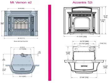

Hey, just checking in on your post. I recently went with the 52i and I pulled out the propane setup I had. Mine was similar to yours, although I had a little more room. I'm curious though, you will need a zero clearance box with your pellet stove, right? Did you contractor quote the unit with a zero clearance box? I'm guessing your propane stove is zero clearance and probably bolted directly to the studs of the house, right? BTW- the E2 is bigger than the 52i. When you factor the cast surround, the e2 is 46in wide, while the Harman 52i is 41 and 13/16 wide. E2 appears to be an all around larger unit. Be sure to check those clearances to combustibles as noted on the web site. Like you, I wanted to keep my wood mantel setup, but when you factor the clearances required to combustibles, it was simply not possible. Good luck and hope all goes well with your install.
Thank you Irish. I am not 100% sure, but the contractor said its a fairly straight forward install. It is a zero clearance and I think is bolted in. I wanted the 52i but from my researches wouldn't fit as it is 41" wide and my opening is only 35". The Quad is only 32" wide so that's are best option.
I've uploaded the file that shows the side by side comparison. The e2 is bigger in most every way. For my 52i I had to purchase a separate zero clearance cabinet that Harman made for the stove. When I look at the install manual for the e2, I don't see that item mentioned, which is odd. So you'll need to confirm that the e2 supports zero clearance installations. Make sure your installer is someone who installs stoves. We don't want to be reading about you in the paper. General contractors that don't install stoves should be avoided.

Ahhhh, the total width of the harman is 41". I must have looked at the dimensions wrong. Oddly enough another dealer told us the Harman would never fit unless we did some demo, hmmm...
