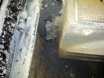

    I have been burning intermittently so far this season, and have tried to clean out the catalyst (I honestly think it is the original catalyst) with a vacuum to keep it at least minimally clean. However, I noticed it did have very significant clogging the last time I looked at it and am currently trying to remove the catalysts in order to clean them until I can order a new one. Hence, the reason for my post. Does anyone know how to get the catalyst out of this type of stove? Pictures are below. I have taken off the flame shield, but cannot get the catalyst/damper housing off in order to get the catalyst out. I have tried loosening the damper tabs, but still not success. any ideas? IMG_20121229_131820.jpg IMG_20121229_131827.jpg

    I have a slightly different Appalachian stove, but am having trouble understanding the orientation of the pictures I am looking at. Are you able to get some a little further away?
    On mine the entire housing rotates about 30 degrees, and there are two tabs on either side that slide out of a track to allow the housing to come down. I don't think your's is the same, but can't quite make out what needs to happen with the pics provided.

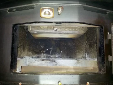

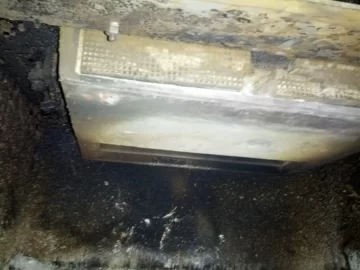

    Do these help with the orientation? I should mention that I have tried moving the tabs to no avail. They may just be "creosoted" in there, but I certainly have not been able to get them to budge. IMG_20121229_140913.jpg IMG_20121229_140855.jpg

    The catalyst holder is held in by those tabs. PB blaster on bolts should loosen them up. That housing is pretty heavy so can be hard to put back in. You may want to pre cut some 2x4s to prop up the housing while you put tabs back in place.

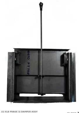

    I have an XLB for 8 years. So far, I've had to replace the damper system 4 times! As you know, not an easy process example, replacing the pin into the damper system itself. The Appalachian Stove company states this is uncommon? Very unhappy with their system. The damper housing melts and warps rendering the damper useless. I do NOT recommend installing one of these stoves.

    OK, I get that now. So, how do you go about replacing the damper rod with the 2 pinch pins? Just about an impossilbe task

    I actually found out later that I have a 32BW, not an XLB. In my 32BW, you can get full access to the damper system by simply removing the catalyst housing. Not sure if it's the same for the XLB. Also, mine has what I believe are likely all original parts (aside from replacing the catalysts and gaskets last year), and it seems to run very well.

    Never had to do it but wouldn't you just drop the whole housing and fix that and put it back up?
