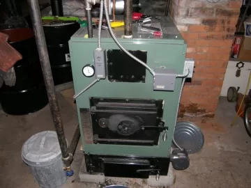

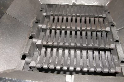

Spent a whole bunch on a new heating system, and wanted to go "all the way" and reduce oil even more. It's a New Yorker WC90, in my sig line... Here's a pic... or two...
Burns much better on coal than wood. No smoke, ever, with coal. No creosote and burn times that go way past twice that of wood.
On wood, I can get as much as 5-6 hours since putting a damper on it. It burns cleaner now too...

Door gets pretty hot.... as you can see by the paint burning off center left. I think it's actually the over fire vent burning coal gas off during light off... that's about where the flame hangs when the blower is turned on with a fresh load of coal in it. Or wood, so far as that goes...
One little ditty I have noticed is you have to watch overfire venting... as it will allow the chimney connector to draft flaming gasses out of the boiler into the pipe. If you haven't been attentive in cleaning that pipe, you will have a fire in it, which will most likely extend into the chimney with "negative" effects if that is dirty as well.

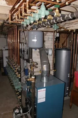

It was a little over 5,500 installed, and yes, I have oil "back-up"...
Main boiler is Burnham V8/4 180K at 130 with the smaller nozzle. Supposed to be 86% or so efficient at that rate. Indirect hot water heater, and ten circulators to spread the heat out where it's needed, only. The wood/coal boiler is 90K. Only have an 8x8 chimney with a 6.5 x 6.5 stainless liner in it. That's the biggest boiler I could get to vent through it. Might have like the WC130 too... larger firebox and longer burn times, but you take what you can get.
