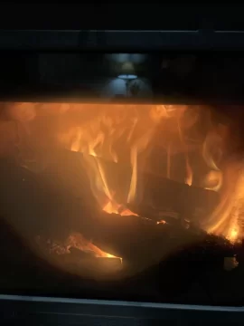

Just started a fire with 3 18” splits of ash. Seasoned for 2 yrs plus. I had the air control open for less than 30 minutes to get the burn started and then pulled it shut. The thing is raging. Is this normal?

Doesn't appear to be raging to bad, but a still picture is not a real indication. 30 minutes before shutting down the air sounds excessive. I would expect about half that with dry wood and kindling. The air can be closed down in increments to maintain better control.
Do you have a flue thermometer? If not, get one. That will help guide you on when to shut down the air. If the stovepipe is single-wall you can put the current thermometer on the stove pipe about 18-24" above the stove top. Tell us what it reads.

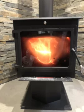

Now it’s about 650*... the first fires I had weren’t like this!
No flu thermometer. Have double wall to the chimney

What you are seeing is robust secondary combustion. Loose piling the wood that way increases air space between the wood pieces and a few of the pieces are not very thick. All of this combines to help accelerate the burn. As long as the stovetop doesn't go over about 750º and there are no red glowing parts, it is likely ok.
Order a probe thermometer. It will really help as a guide to when to turn the air down.
Is there a blower on the stove? If you turn it on that will cool down the stovetop by about 100 degrees.
Thank you. Yes there is a blower. Turned it on and it quickly went down a bit! I will get a probe thermometer ASAP. This thing is touchy I guess huh. Not used to this one as I am the old stoves. Thanks

Your response is normal. Try loading the stove N/S, with the wood stacked parallel to the sides of the stove and not much of an air gap between the pieces. Start turning down the air as soon as the wood starts burning well. Turn it down until the flames start getting lazier, maybe 50%. (probe flue temp around 400º) Then wait about 5 minutes for the flames to regain strength. The flue temp will rise again. Now, turn down the air again until the flames slow down once more. Try to keep the probe flue temp under 5-600º. Once the flames recover strength, close down the air all the way if possible or until the flames slow down again. The stove temp will rise as secondary combustion gets strong, but the goal is to keep the flue temp under 600ºF. Ideally, when things settle down and the stove is cruising, the stovetop will be around 650º with the flue temps around 550º.
