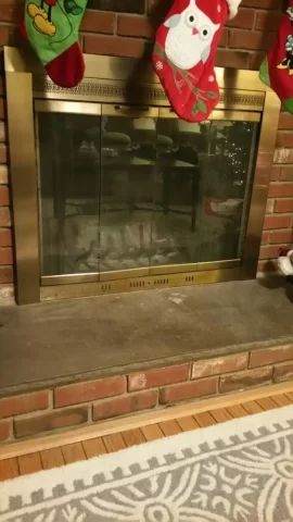

Hello again. I have an installation coming up this week and I'm hoping for guidance on a hearth extension. My current hearth is about 20" and the insert we're buying extends 9.5" onto the hearth and requires 18" of clearance. What's the easiest, cheapest, fastest way to get this taken care of? Is it as easy as buying one of these Type 2 hearth extenders on Amazon and laying it on the floor in front of the hearth? Does that count, or does it have to be flush to the existing hearth?

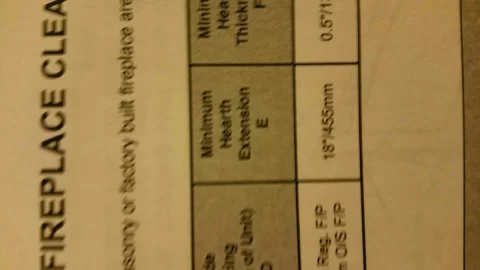

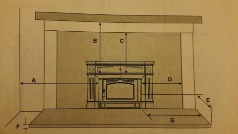

I see that in the manual. My confusion comes from measurement "E."

Yes, you will be fine. You're extending the hearth at floor level.
