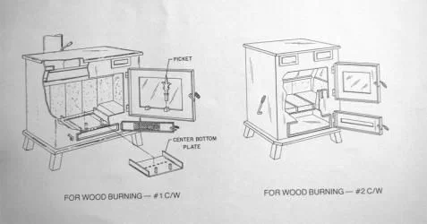

pic is from manual that was on previous thread.

No firebrick, you'll need the grates for the coal fire. Air is provided below the grates to the coal fire.
I think you have a Russo wood stove. They made a couple models that look just about exactly like the coal stove - one earlier model and then one catalytic model. Both were very decent stoves.....but neither were convertible to coal. There are not Russo models that had retrofit coal grates - meaning if you stove does not have them, it cannot have them.
The coal units also had custom refractory in the sides, while the wood units used standard firebrick.....
I thought it had firebricks on the bottom, but can't be certain. It should be somewhat evident by the way the grate and the metal plates fit in. Either way it should be OK as long as you keep a decent bed of ash on the bottom.

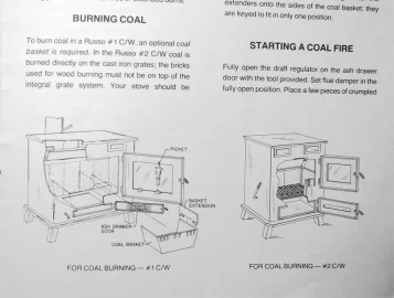

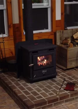

It's good to see pictures floating around from my original manual, glad they help. My old Russo stove was a CW#2 (Smaller one) it had 3 firebricks on the bottom and a shaker grate underneath, my manual says it requires a coal basket to burn coal. My manual also states that if you have the the CW#1 Coal is burned directly on the cast iron grates....( please read picture from my old manual , it is different from my other picture you have posted. ) I have also posted a picture of my old CW#2

I suspect that is a really old manual. In the 1980's when I sold Russo, both the #1 and #2 CW came only one way - with the grates and set up for coal stock. There was no basket of any sort - as I mentioned, the grate were built in with an external shaker - I remember it on the right side of the stove, but that manual shows it on the left. The "basket" was formed by refractory.
