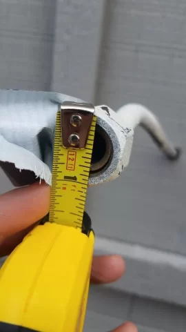

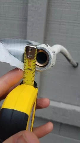

Hey guys - 1st post here. If its the wrong place so sorry and just direct me where I need to go.
Just moved into a new house with a propane fireplace. The old company was charging to rent their propane tank and I decided against that because I have my own.
I should of taken a picture of the old regulator.. but can you all direct me what I need from the pictures below to hook it up to my propane tank? The fireplace is already set up and ready to use - just need to connect the pipe to the propane tank.
If you could provide links for what size flare I need / regulator it would be much appreciated. I can measure if needed.

What is the diameter of the copper pipe? Is it 1/2"? 3/8"
Measure the OUTSIDE diameter of the pipe - behind the nut...
You should be able to get a 1/2" MALE fitting at your local hardware store.
The other end will either have a male or female pipe thread, depending on
what you need to connect to gas line coming from your tank...
thanks for all the help - it fit perfectly
