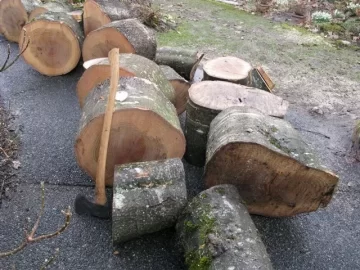

I am a new poster to this forum, which I have found very helpful. I've done a bit of splitting with a wedge and a cheap axe. But now I have some very large red oak logs (see picture). The biggest are 24 inches across. I've tried with a twisting wedge and a sledgehammer, but can't get any purchase. The wedge just bounces out of the bigger logs
I could try and rent a gas powered splitter, but would love to know if there's a way I can split them by hand. Any suggestions on the feasibility of this, and the appropriate tool? I looked at the Fiskars 28" splitting axe, which has been well received on this forum, but frankly it doesn't look up to the task. The store also had some heavier axes with a wedge-like head. Surely I need weight?
And are they easier to split when green?
Thanks for any suggestions.

Man, I'd set them bad boys up, fire up the chainsaw, and cut a groove in 'em down as far as necessary. I've done it several times in the past, cut down into it about the depth of the bar, then start your wedge in there, and she'll bust open for you then!
I would recommend renting a splitter, maybe you could bang those out in half a day. If the splitter is only horozontal, then having a friend help will make your life easier.
good sharp wedge & a 10 pound sledge
other guy had a neat idea about cutting a groove so wedge has somewhere to start
also try splitting off the sides first don't go for the middle of the round off the bat

I've had some rounds like yours that will tend to bounce the wedge out. Here's some things that might work.
Look closely at the surface of the sawn face to see if you can see any radial cracks starting. Try starting the wedge there.
Use a wedge with a fairly acute taper to start with, then bring the bigger wedge(s) in when the skinny one is pretty much buried.
Leave the rounds so the sun will start to dry them a bit--that starts the radial cracks more quickly.
On a few I'd tap them in and get them started using a three pound hammer (baby sledge). The control is better for me. Then start with "medium power" hits with the sledge or maul to drive them in a little more deeply. Then, start hammering away.
When you start in with the sledge, stand so the wide part of the wedge is directly in front of you. If the wedge comes shooting out of there, it'll probably go off to the side.
There's other folks on here who have much more experience than I do, but these techniques seemed to work okay.
Good luck.

I split red oak rounds like that pretty regularly. I use a maul and I think the trick is most people try to split the log in half first. I take off a slice a few inches deep first. Try to stay at the edge of the heart wood with the first split. Once you get a piece off it tends to get easier when you work your way around the log.

I agree with hurricane . start around the edges and work to the center. I use a 15lb maul for large rounds i can break a 30" chunk of oak in one swing . Cutting the rounds to start a wedge works real good also. John

Some good advice in this thread. Like others have said, it's probably best to try splitting the outsides off rather than trying to split it right in half. Try putting the wedge parallel with the outside of the round rather than perpendicular and about 3-4 inches in from the edge.
Are you sure you are dealing with red oak!!!! That bark doesn't seem to have any furrows at all. Unless it might be pin oak which both stinks and can be hard to split. I let big oak rounds sit on their sides after cutting green and left them dry some and hopefully open a crack. But they can be a pain and I can have three wedges and a sledge going to try to open them up. If they have deep knots inside the chainsaw may be the next option. Good luck with that. Tony
I'll chime in to say that, like a few others who have already replied, I think those could be split with a maul. Sharpen the maul, and try a few different spots until you find one that gives a little. I find my maul bounces off wood mainly when I hit twisted grain caused by a branch or burl. If this happens I try the other end of the piece.
I hand split some nasty oak this winter that was similar in size. The suggestion to cut a groove in the round for the wedge is an
excellent one. That did the trick for for me. I also split around the edges when I can, but some of rounds would just
chunk off the first couple of inches off the edge without cracking the round. No problem at all once I made the groove
with the chain saw.
