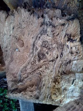

I just split some oak this weekend and fortunately had the help of a splitter. I was sure glad to have access to the splitter. I'll try and get a pic later to post . . .the grain was so twisted I called it Birds-Eye Oak.
Here is an example of the oak 'burl' the splitter helped with:

A contrarian view here...
I never saw any kind of oak with bark like that. Some kind of beech maybe?

Man I had some red oak like that. Real big at the base and unsplitable. I rented a splitter that would go vertical and just twisted them under it. The splitter made short work of everything. The problem with the logs are that they are going to be real stringy when split. Its gonna be a bear to do by hand but the splitter will get it apart enough to avoid the stringyness.
Mark
The red oak in my front yard has bark exactly like the stuff pictured, but only on the branches. They're huge branches, though. The trunk is very creased. If these are trunk sections, I'd suspect maple.

The bark in the pic from the first post certainly doesn't look like any red oak I've ever seen either... Branches yes, but not a trunk of that size. If it is red oak, it can be some of the easiest splitting wood there is. Based on the picture and having issues splitting it, I would be very surprised if that is truly red oak.
OK, so, not to deny the possibility that it's not red oak, but the tree in my yard has branches easily as large as the ones pictured, with similar bark, and it's indeed a red oak. Additionally, I've had trouble splitting oak at that size, even with sharp wedges. There may be a difference in species from west to east. Without seeing a close-up of the grain, we won't be able to tell from a picture on the net, but I'd say it could very well be red oak.

I agree with the guys that say that doesn't look like red oak. It looks like beech to me.

Put me in with the "that aint red oak" crowd. You would have an easier time with it if it was red oak, I bet. Fresh red oak splits pretty easy unless it's huge or has lots of branches.

bark is too smooth and grain much too big for any around here.
