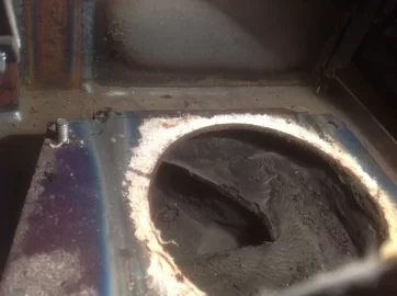

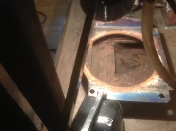

When they cleaned it did they pull the fan out and clean under it and replace the gasket? Does it spin freely?
A bunch of junk accumulates under there. See photos of before and after [Hearth.com] Help with St Croix Afton Bay[Hearth.com] Help with St Croix Afton Bay
