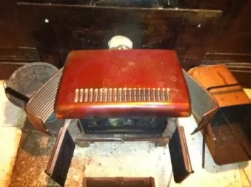

    I'm looking for some help, i'm currently caretaking an old big house and I think the stove that's in the hall is a 'Smith & Wellstood lo courtier stove'. It's like a burnt red colour and as far as I am aware the last owners bought it approximately 30 years ago. Can anyone tell me about it and it's fuel requirements, i.e. coal, anthracite, wood?? We purchased a fan to go on top of the chimney due to lack of wind and it worked fine the first day and now again smoke, smoke, smoke! :-( Can't find any manual on line and I desperately need assistance.

    Pictures man.............pictures.......
    Inside the stove, around it (not just the face of it only).........etc.

    Right oh will photograph it when I get home from work!

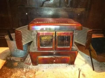

    Yes I think it is prior to Esse but it's to be used as it has always been up to about ten years ago when the owners husband died. Unfortunately out of all their family he seems to be the only one out of the entire family who knew how to deal with it. I've attached a photo here, I have four more but am appearing to be still technologically challenged by importing five at one time so you'll all have to excuse me as I'll have to create a new post for each one, even having followed the instructions it still dumbfounds me.

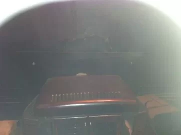

    Image 2.....

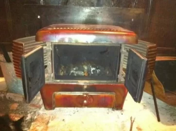

    ...Image 3

    Good gosh!!! That's one Retro-looking unit!!!!!!

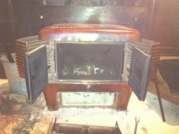

    Image 4

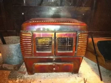

    Yep, fairly out there all right!! And finally.... Image 5!!! :)

    That is a pretty outrageous looking stove. Thanks for the pictures. Why do the sides open up?
    I am suspecting the flue connection may be the issue here. Can you describe in detail the entire flue system including approximate lengths?

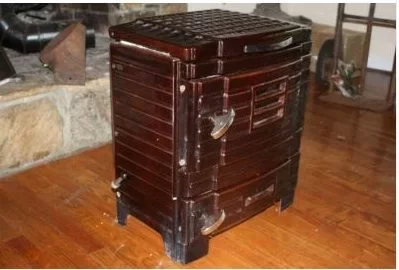

    My guess is that these are french stoves - from the era of the Chappee......
    See enclosed for the popular model - we sold it and it was somewhat popular in the early 80's. As I remember, the distributor was in Maine and may have had a name similar to the one you mentioned....
    I can't speak for that exact stove, but most of these models were made for coal or briquette (coal wood mixtures molded into bricks) which used to be popular in Europe as stove fuel.
    Here is a wood burning model.....
    http://www.c20fires.co.uk/stoves/s148.htm
    Closer inspection of the inside may help determine if it was more coal than wood.....if it has shaker grates (grates can move), then it is probably coal. If it has a fairly large ash pan - that usually means coal...
    Do some google image searches on chappee and you'll come across some of their stuff......not exactly similar, but close.

    Completely outrageous stove alright!! :) The sides open up to allow the doors to open, if they are completely closed you can't open doors, it's a mad thing altogether!!

    Ok people, it goes like this I have smoke everywhere as I post!! I received a reply today from the Esse Company and they told me as follows;
    "The picture shows the Lo Courtier Model finished in copper lustre. This stove could be run with the doors open by concealing the firedoors behind the wings if so desired. These stoves were made from the early 1960's until 1988. lots of these stoves were sold to British Rail in the early days. Sadly we have no spare parts left for the courtier".
    I, delighted with some information then requested to see if they had any manuals kept for use and for chimeny specifications etc and what fuelis required and this is what follows;
    "I am struggling here. I can't find any old instructions for this stove, but the fuel used would certainly have been solid fuel such as Anthracite, Phurnacite, Homeheat (????? anyone tell me what that means????) and Pureheat (???? again, I don't know what this is) but not black Bituminous Coal or Petroleum based fuels such as Petcoke" (again what's petcoke??)
    Me, being me, thinking all I have done wrong was to use coal (that we use in the regular fires around the house) and being so excited have just come home lit the bloody thing using dry kindlin to get the antracite to light and I can't see for the smoke and I have the fan going which we put up on top of the chimney (€400 down the drain I think!!). Smoke is just coming out the top like there's no tomorrow!!
    Oh, by the way, the round thing on the front is for a tool to look the doors is all, there is a side handle that you wiggle to shake the grates!
    Yours in disgust,
    Marja

    I know you can't see it properly, but that is smoke in the air! I've the front door and back door open to clear it, am going to seal it up now and give up....again!!
