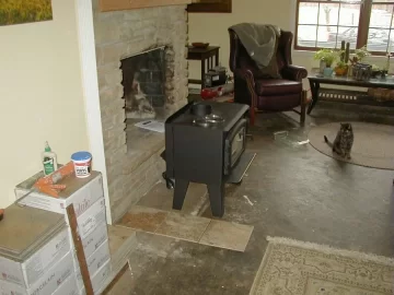

A Drolet Eldorado and attached is a photo without the stove pipe attached.
As you can see I'm going into a fireplace and although some expressed doubts it would work, it did perform pretty well last season. But to get a good draft, I had to leave the door slightly open. (very slightly)
But this year I'm getting smoke even out of my double wall stove pipe.
I realize I need to go straight up with my stove pipe but was forced to have a horizontal run into the chimney.
I'm going to disassemble the pipe and clean it out but I don't think that's the problem -- besides, would rather work on a permanent fix.
** can't do (2) 45's, don't have the room
** is there such thing as a chimney mounted fan that will help draft? like a fan built IN the chimney cap?
** I'm crazy enough to cut the legs and try to fit INSIDE the fireplace and then have the stove pipe go straight up but only as a last resort
what say you ??

maybe its the angle the pic was taken, but it looks like the 45's would work??
nope -- wish I could but already tried it -- do they make something less than 45? thought there were adjustable elbows, that may be worth a try.
Do you have any photos of the pipe connected to the stove going into the fireplace? Are you using a ss flex liner inside the chimney? If I had to work with your set up I'd run my vertical pipe off the stove straight up as far as possible before putting on my 90 degree elbow to shoot into the fireplace opening. I would then connect the horizontal pipe to a ss T-connector fastened to the bottom of my SS flex liner. I would also push the stove back as far as possible toward the fireplace to minimize the length of the horizontal run.

First, the stove did not work for you. If you had to leave the door open to burn it than it was barely performing better than a fireplace.
The optimal solution would be to either get an insert for the fireplace or a stove that can be rear-vented. Another option would be to have a 3' vertical run up and then a horizontal one into the chimney. Depends how easy it is to drill a hole into the wall above the fireplace to access the chimney. How tall is that chimney total?

Do you even have a liner? That along might sold your draft issues, without a liner it's gonna do very poorly to say the least!
I would save my $153 for the blower, sell the stove for $300 and buy an insert with a liner. This whole set-up looks doomed from the start to me! No matter how much $ you will save by burning wood it isn't worth the risk of fogging out the family or causing a fire.
New SS liner, insulated well -- all is fine but it's that horizontal run that's killing me. I bought the AD1 fan but realized last night that I have double wall pipe which may be a problem for that thing. (and I'll take my chances on losing power, it's never happened in 5 years living here).
Grisu inspired me to think about a new stove when he said get a rear vented one -- so that is the plan. With the rear vent I could easily do two 45 elbows and the fan IF I need it.
