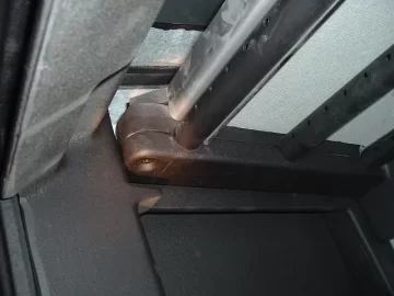

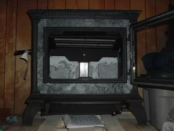

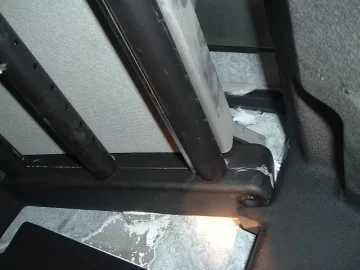

Some pictures to get your valued opinions:
1) The stove still bolted to the pallet, door open. Check the ceiling.
2) The front left manifold support tab ought to support the manifold, I'd think. Easily fit a fat finger in there.
3) Same view of the right side. Much smaller gap but still 1/8" or so. Not the cement on the wall holding the manifold in place.
I can take as many pictures as you folks might need to better help you form opinions. Is it boogered? There doesn't look to be much holding the manifold in place other than a single attachment to the secondary air duct on the back wall and then all the cement.
Thanks for your help, don't be shy.

That doesn't look right to me. Maybe it shifted during shipping? Can you move it around any or is it solid? Where did you buy it? Does dealer know about it? Maybe send some pictures to Hearthstone and let a tech look at it.
It is solidly mounted, nothing in there moves which is good if it was in the right place. I didn't hit it with a sledge or anything but certainly gave it a healthy tug to try and get it to set down. I picked the stove up on Friday and will bug the dealer on Monday but I would like to know that this isn't proper before I spin him up. The dealer is about to close his doors after 28 years so I need to hit this issue from all fronts.

I can see the skew, and the fact that one side is not seated on the support tab. If you have a healthy "C" clamp say a six incher, try clamping the raised side and gently applying pressure to lower it in place. It may be that the move to the skewed position has wedged the tubes and they will not move without some help. Rather than strike the metal, try and ease it in place.
