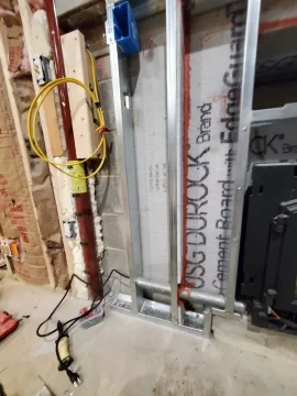

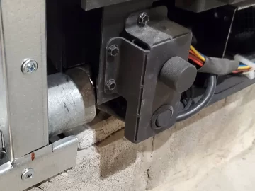

Can you post a picture of the setup showing the proposed location for the hidden outlet?
Hopefully my photos post. I had some 1.5" conduit sitting around.

what gthomas785 said is the code. if the fireplace has a cord on it then it is the disconnect. i generally run a mc wire up thru the clean out because romex is not legal to run thru or into brick. then mount a outlet where the fireplace has it's spot to run to (usually the right side) and plug it in. the remote is the on off switch but i usually run a switch on the right side of the fireplace incase the remote doesn't like life anymore
