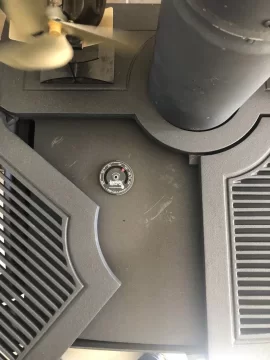

Picture: Shows main air, and two additional hole (I'm assuming air wash and minimum burn?)

Can you show what would be a typical load of wood in the stove to reach that temp? How is the temperature being read and where? I helped put in a 2020 T6 LE last year on a 20', straight up flue and it runs pretty much the same as our 2008 T6. Part of the problem may be the way the stove is loaded. Do you load lincoln log style or crisscrossed wood, or all aligned N/S?
The hole with the weld bead is for the boost air. This is not necessary, particularly if the draft is strong. Try putting a magnet or some metal tape over it and see if that helps. Also consider adding a key damper to the stove pipe to reduce draft strength.

I have tried both N/S and E/W loading with little to no differences in rate or temperature of burn. E/W does seem to be little more controllable, but not by much. My load typically consist of oak splits (roughly 4-5 inch diameter, 18" long), and I stack them in tight (minimize air space between pieces) to about the hight of the fire brick. I'm seeing an average 10 hour burn time (with plenty of coals for restart). For small fires I've been placing a couple pieces of oak (same size as mentioned above) N/S right next to each other or one on top of the other, in the center of firebox. I agree with you on the temperature achieved with so little fuel, but I also like to be able to control the burn. I know there is a learning curve, but I'm struggling with this one.

Stove top temperatures are measured with a magnetic thermometer on cook surface. Picture attached. The stove temp showing in the picture is from a couple pieces of wood added at roughly 5:30 AM. I'm a fan of the stove, just need to work a few things out.

That's the right spot to read. Next fire, try closing down the air sooner. That makes a big difference in how hot the stove ultimately gets. Turn down the air as quickly as possible without causing the fire to smolder. Usually, with hardwood on our stove, this is around 10 minutes, when the flames just start licking the baffle. I turn down the air enough to slow down the flame at that point. This is about a 50-60% reduction in air. Then wait another 5 minutes until the fire regains strength and turn it down again until the flame gets lazier. Wait, then repeat. By the third time, our stove's air is turned all the way down.
You are doing well and to be congratulated for having good dry firewood. If tweaking procedure doesn't help get the stove where you want it to be (650-700º stovetop temp), then try blocking the boost air port and consider adding a key damper to reduce draft once the fire is burning well. FYI, our stove's boost air port has been blocked for most of its life. With good draft and dry wood it has not been necessary.
