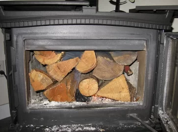

We don't have splits smaller than 3". If we did, I would save them for cold starts and not on a hot coal bed. This is a typical reload that we burn on a hot coal bed. It will bring the stovetop up to around 650º typically.

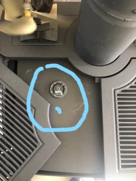

That's great news let us know your stt after a while and if still getting up to 850. Below is a photo of op stove and I have the same discoloration in this area and seen it on others. Also the mark in middle is where i am getting my highest readings. I agree it works good but 850 is pushing it for me. Its good to hear from others that PE said 850 is ok with no glowing. They need to update the manuals with temps.

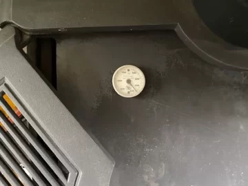

Our stove has never seen 850º stovetop temps in a dozen years of burning. I would need my IR thermometer to read it. Our stovetop thermometer tops out at 750º. This is what it looks like after 12 yrs.
