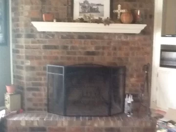

I'm sorry, but I don't know what an open fireplace is. It's a brick fireplace, only open on one side, in our living room. Does that answer your question? Pardon my ignorance! Here is a picture...

Does the fireplace have clean metal sides inside the firebox, not brick interior sides?
I am guessing it is due to water coming in and resting on top of the smoke shelf and rusting out the smoke shelf. If the rest of the smoke shelf is not rusted I would weld a piece of plate steel over top of the hole if you are going to continue using this as a fireplace. Now getting in there to do this job is going to be tricky, you could cut out the bricks to get access to the smoke shelf from the back side then do the repair and then put the bricks back.
Or you could see this as a sign to install an Insert or Free Standing rear vented woodstove in front of the fireplace with a stainless steel liner going to the top.
