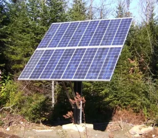

Dont get caught up chasing the efficiency game, assuming you have a place to mount the cells, its lowest dollars per installed watt that is the most important with siting a close second. Most of the roof mounts out there look great, but the lack of adjustment for seasonal angle and the higher temperatures up on the roof compared to a rack system offsets any efficiency savings. It is also a heck of a lot easier to clean off the snow from a rack and the steep angle in the winter keeps the snow from building up on the panels .
The rack in the picture may not have the most efficent cells, but its payback is less than 2 years as I bought the cells at a garage sale. The tilt angle is reset 4 times per year and takes about 3 minutes.
  • [Hearth.com] . . holes in my 'solar' math?
