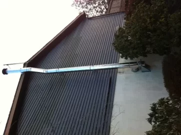

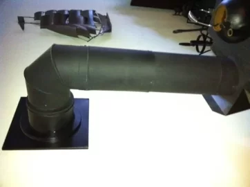

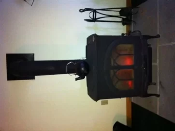

Here are the pics you requested.
I don't know why they are off 90 degrees.. Not that way on screen..

Looks like this is a basement install?
is that a 90 then say a maybe 2ft horizontal into another 90?
That's a lotta chimney to seemingly have a draft issue, but it does seem to be possibly a draft issue ..

during your normal operation, as far as the red collar that is simply from leaving door cracked to long ... it was Prolly a vortex trying to get up that chimney and the 90 restricting it because normally it should have been the 90 getting red..
try getting temps off your pipe , running it with so much air that pipe should be hot! if not we def know there is a prob. somewhere.

The chimney is Simpson double wall(I think).
Yes, a slight rise.
This has been a slow/cool burner since stove 1 and day 1. The spark arrestor is clear. I used to think it was green wood, but this is 2.5 years of drying now.
When the outside temps got to below zero, I get the hottest burn and need to cut the air due to approaching 600 degrees. I do cut the air daily, but that's because the room is too hot. At night, I can leave full load of wood and full air and never see temps over 500.
Personally, I don't think these f600's have enough air intake.
Otherwise, I think the chimney could be higher by 3 feet.

I don't know, this stove just doesn't seem to be drafting correctly. We need to find out if your chimney is insulated. Tell us how you are storing your firewood.
UPDATE**********************
I started the stove with just a few coals left early this am. I cross stacked the way I did when I had the problem. This time I stayed with the stove for the first 10 minutes. I was able to close the door fairly soon today(10min).
Some of the wood sizzled slightly from the ends and only near the long ends(probably moisture that settled slightly into the wood).
I went upstairs and turned on a few vents such as bathroom and stove. After 20 minutes more, I was reading some temps which I believe were rising faster than normal.
Stovetop thermometer 475
laser at same location 460-485
laser of top middle 970
laser of connector(part that was red before) 885
laser of stove pipe above connector (1 ft above stove top) 680
Then I looked again..... WTH....... I turned off the lights and what did I see..... a very slightly glowing red connector!!!!!!!!!
The air was of course full on as usual. I turned it down and came to write to all of you...
So I guess it wasn't the door being cracked open the other day that caused it. It may be due to the excessive amount of exhaust keeping heat in the pipe or it may be drier that I have ever had wood(except for the sizzle).

new temps..
stove top thermometer actually rose to 500 and the water is boiling.....
laser of collar is 880
laser of stove top middle is 950
with all lights off it is barely perceptible red glow...... I mean you really have to look hard to see it.
What part of this is normal?
Maybe after 2.5 years I have finally been experiencing dry wood.....
forby said:
20 minutes later.........
So the air was turned down to just below half about 20 minutes ago before I wrote my previous post.
new temps..
I'm not familiar with your stove but is 950 in the middle of the stove top an acceptable temp? That seems hot to me, what is the listed overfire temp of the stove published by the manufacture? What is the placement difference between the stove top thermometer and the place the laser reading is taken on the stove top? I'm wondering why there is such a large difference in readings.
