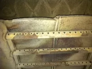

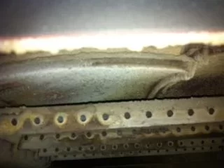

BIG Update......
The baffles are warped bad!!!!!
Apparently, the instruction book is wrong!!!! It clearly says "Once the stove has reached a surface temperature of 400-600 degrees, adjust the primary air control lever as necessary to generate the heat output and burn time desired.... The optimum surface temperature range for the most efficient burn is between 400-600 degrees."
It's a lie. My stove has never reached 600 degrees according to the temp gauge!!!!!
My dealer told me the air should be adjusted down when the fire is "active". WTH is really "active"?????? It would be nice if Jotul told me this in the instructions....
WARNING: IF YOU GO BY THE BOOK YOU MAY MELT YOUR STOVE!!!!
I warped by baffles by staying well under 600 degrees.
I'm not happy!!!!!!!!!
pics....

On the stove top maybe......But with a glowing stove exit the flue wasnt under 600. I think the high heat you were throwing up the flue may have played a roll on this one. The practice of leaving the air wide open allows all the heat to rocket through the stove. That and leaving the door cracked for start up air. Im sure the dealer can order you a new baffle. And the good news, i think you can install it with out removing the top of the stove to since it is a split baffle.
First make sure the temp gauge is accurate. Many are not. With that flue collar glowing I strongly suspect the stove top was far over 600F. From the description, the recent overheating of the stove didn't happen by following instructions. It happened by walking away from the stove with the door open.
