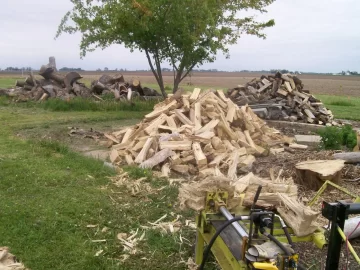

Heapenhausen - much more stable and never falls down.:cool:

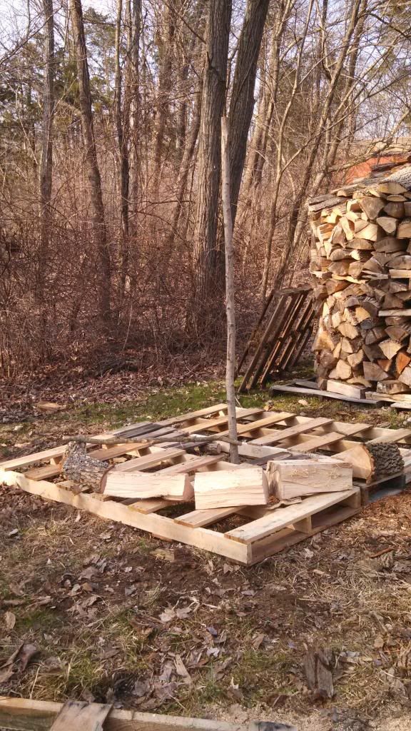

I go out and cut the straightest maple tree of about 3" dia I can find to about 8.5-9', and drive it in the center of where my stack will be, with about 7' sticking out of the ground and use a level to make sure she's good and straight. Then I cut another limb with a "Y" to whatever my radius of the stack will be. I use this for my gauge to know how far from the center each log is placed.

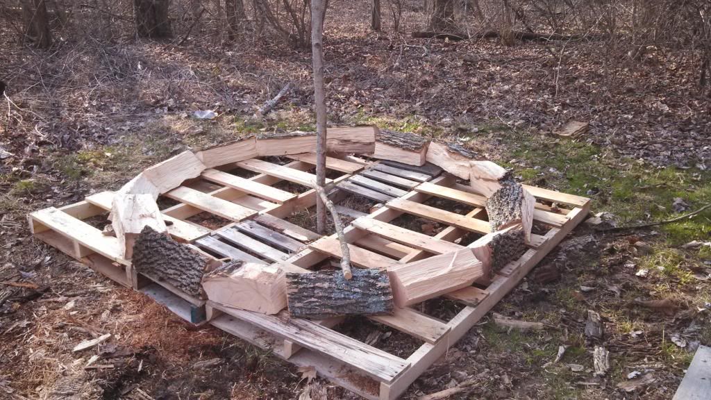

I've been using splits to make my outer ring, but bricks will work fine too.

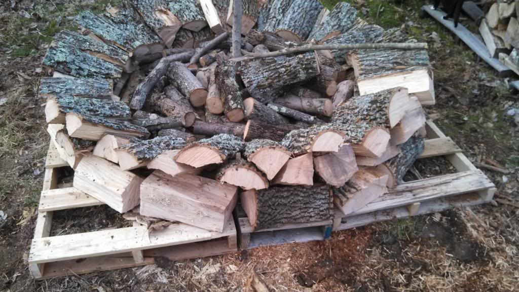

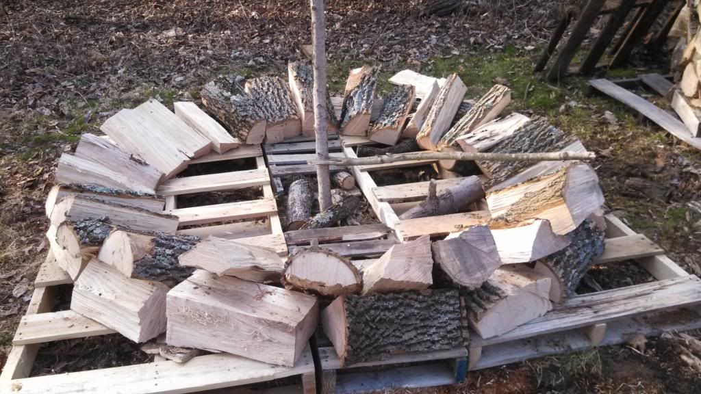

After I'm a couple passes high on the outer ring, I start tossing rounds and crotches in the center. Be careful around the center pole though, it's easy to knock it off being plumb.

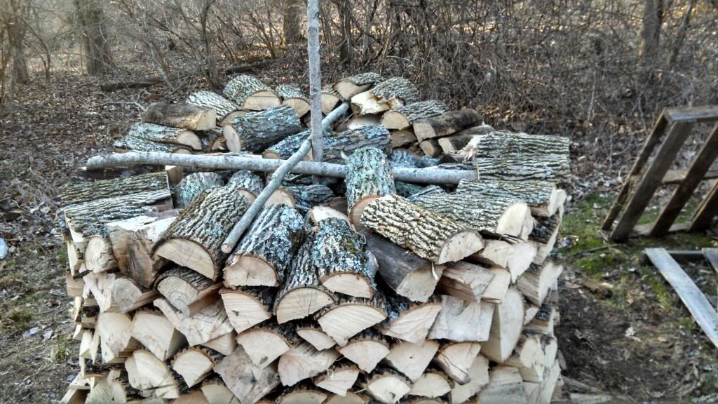

Once I'm just past the half-way point, I go and cut a couple more straight saplings to the diameter of the stack, and place them cross-ways creating an "X". The weight of the wood on top of this should help the stack from bulging.
