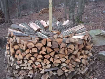

    Al, I'm also on HH #3 which is also going to be about 10' in diameter (at the base).
    For the first 2, I stacked the centers vertically on end but for this one I chose to toss scraps and irregular pieces as you are planning to do. Obviously, I think your plans for your third holz hausen are perfect. :)
    I'm about half way done with mine. Here's a pic:
