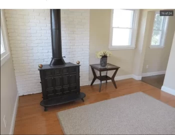

Builder bought a house that was completely gutted and rebuilt. Nice but i didn't know they can make hearthpads look to be of wood flooring material...(Sarcasm...) Or maybe this stove doesn't need it...regardless not in my house!

That setup is strictly for show and not for go. Hope the inspector flags that one.
Maybe this is a new idea in stove design. You don't have to keep feeding it wood because it merely burns up the hardwood floor. :rolleyes:

Possible ceramic tile flooring simulating wood?
Even if that was the case I think a higher R value is needed for this Franklin.

Something just doesn't smell right. (like a housefire smells)

On a positive note, at least there is a brick backing (but close enuff to cook the paint).
As a safety precaution, there's a nice rug to catch embers so the floor doesn't get burn holes.

Makes you wonder about the rest of the house.
