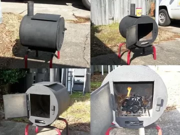

Okay,
I brought it out in the sun and took some more pics. I stuck a cup on it in one to give you guys a better idea of the size. I put a handful of kingsford charcoal bricks in it and lit it up. 5 minutes later you couldn't leave your hand on the top plate. 30 minutes later, the latch was still cool to the touch. The face of the stove remains considerable cooler than the sides and the top. Thats actually a relief. You will notice the grating that I spoke of in my previous post. One hour later, the bottom of the tank was still cool to the touch, (very weird). I also noticed that the charcoal was making almost no smoke whatsoever. I was trying to watch the flow, so I had to add leaves just to make some smoke to see. I hope to make the door for the vent this weekend.

After tinkering with my stove for a good deal this weekend, I found my next "dilemma". When I had it piled full of wood and a lot of smoke in the works,.. two small trickles of smoke emanated from the top corners of the door. Not a lot mind you,.. but enough to be a nuisance in an enclosed area. I think that the only issue is obtaining a better seal for the door. Since it is simply metal on metal right now, I'm sure it can be accomplished. I read this morning about a product called ceramic rope by "Cal Seal". They make it in all sizes, and the 3mm looks like it would achieve the seal I need. Everything I've read indicated it would work in this situation. Any thoughts?
I'd say the smoke was pouring out mostly because you have no chimney connected to the stove, and therefore no real draft.
I bet your door will be fine with an appropriate chimney on there which will pull the air through the unit. Right now, the smoke is fighting for a way out and air fighting for a way in.
pen
If the stove was drafting properly smoke wouldn't come from the door even when it is open. So a seal, while it may make a burn more controllable by making all air entering the stove come in through the air adjustment, it is not meant to keep smoke out.
pen

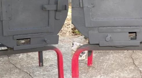

Well,... I finally made the air vent. I ended up having to use welding rods as spacers. The welding rods were tacked on to act like the guides, then I welded the flat bar in place and filled in the gaps. I then welded a nice big bolt on the sliding door to give me something to grip. The door slides good and is nice and snug.
I'll buy some more pipe this week so I can dispel the venting issue next.
It's getting there. Slowly but surely.

Burned it again this evening. I haven't bought the additional pipe yet, but wanted to see just what the vent would do. I didn't notice much smoke from the door corners, but did get a down draft or two with that short pipe.
