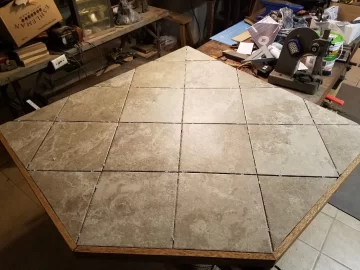

Couldent find a stove pad i liked locally so i decided to make my own. I like how it turned out. Going to grout it today and set my trp-22. Have to add, Andy from amfm is awesome. He talked me thru the process like the newbie that i am in a totally professional manner. Ordered tue, and it was here fri! Totally recommend.

Very Nice What do you plan
for the edges? Or are you just going to
finish the frame?
The pad is 1.5" plywood, capped by 1/4" hardybacker, then std floor tile. The 3 visable edges are miter cut 1by oak stained with minwax to hide all the layers and give a finished look. Sucker is HEAVY!

I made my hearth pad also, it was way cheaper than buying a commercial hearth pad and I got what I wanted.
Reactions: tbear853
Nice work. I had thought about doing something similar as the nice looking ones were so expensive.
Im sure the reason for the high cost is r value required for log burners. Since i only need ember protection, this lower cost option was the way to go.
The one my Uncle and I made (he did most of the work) was super heavy too!! Did not anticipate the weight...it was fun to get up out of his basement and into my house!
