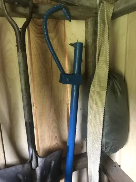

I would like to start a thread for people to post anything they use to cut/ process wood that they made. Some of the tools we use can be expensive to buy and quit a few of us have to skill and creativity. I would like to see what types of tools you all have made yourself. Here are a few of mine.
A cart made from scrape gas line and the front spindles off a junk mower
A C clamp turned into a sharpening vice.
A cant hook from scrape metal and rebar.

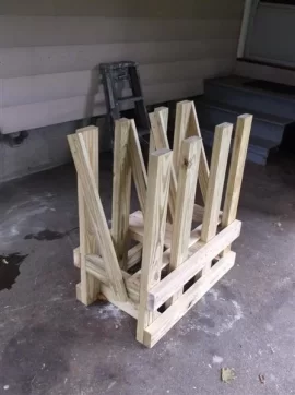

I guess I built a custom rack for cutting 30 cords of splits down from 22” to 18” length, when I changed stoves, but that went on the fire pit when I was done with it.

you wouldn't think of burning that pine in your stove huh? I really need to get one of these built so i can cut down to length...

After cutting 4 inches off of every damn split of 30 full cords, and collecting every one of those little off-cuts to pack into the stoves around loads of wood, there was no way I’d deny myself the pleasure of burning that rig. Watching that thing burn was akin to throwing off the heaviest shackles, after three years of that continuous pain.

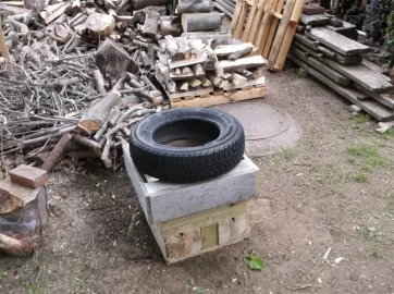

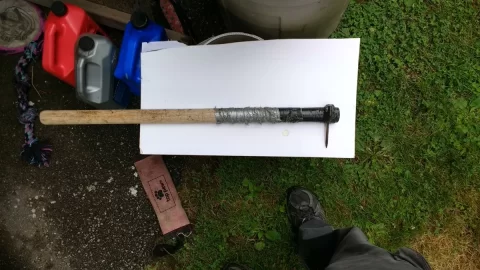

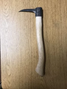

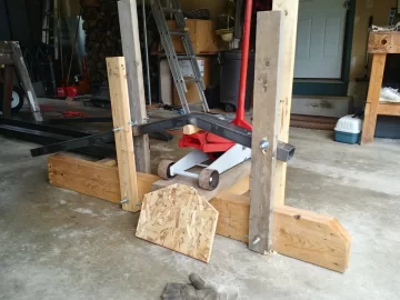

Here are a few things I have made over the years
Chopping block
Cutting jig
pallet fork
pickaroon(aka zombie killer)

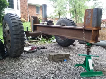

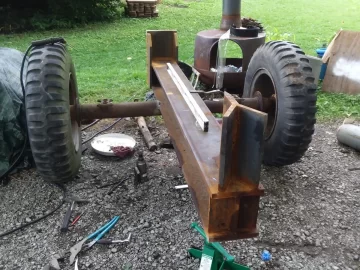

Something I started to fill in my time from other projects. Pretty insane (and I'm having way too much fun building) the end product will be a fast 50-55 true tons log splitter. 40 gpm pump and valve, 7"x29 cylinder with 5" rod. For scale, that beam has 1" flanges.

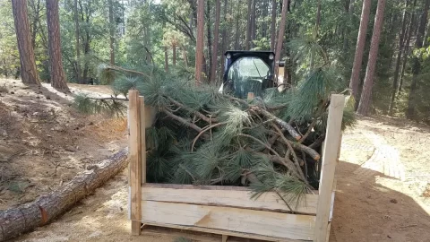

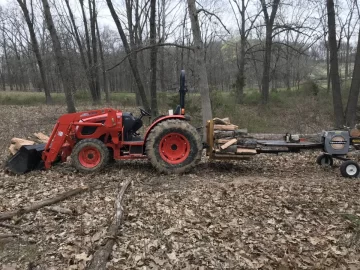

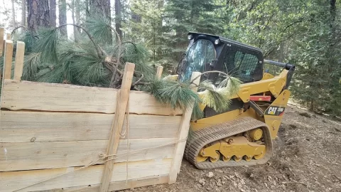

I made a box for my pallet forks from lumber I milled. It's about 6'x6'x4', so it's called the Cord Getter. Slats on the front come off for loading, then get added as the box fills up. The tractor will barely lift it if it's completely full of wet rounds. When I'm splitting I just chuck splits in there and drive over to the stacks when it's full. Dumps out very nicely, or position it tilted forward or raised for ease of stacking.

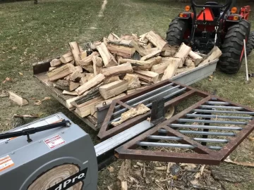

My modified splitter has made things much easier on the back. The table prevents each piece from falling straight to the ground after the splitter cycles. Really speeds things up! I didn’t do the mod though, an innovative old friend did.

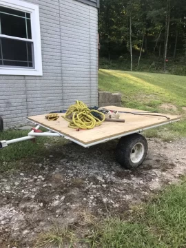

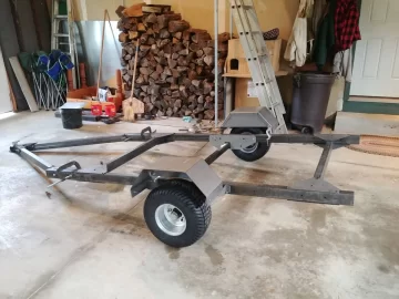

Bolted trailer.
2x3 11ga tube
2200lb dexter axle
10" ground ht for tipping rounds

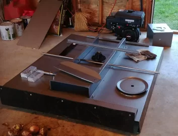

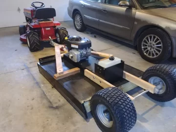

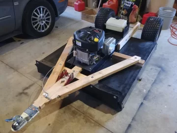

Homemade brush hog with swisher spindle and blades, 17hp brigg

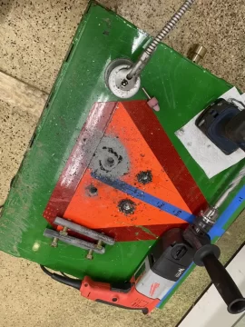

I’m working on a tunable ballast box for the new tractor, that can be reconfigured to 700, 1100, 1500, or 1900 lb. also integrating a few other nifties, like rake and shovel holders, trailer hitch, grab hook, etc.
It’s based on this 700 lb platform from my older and smaller tractor.
[Hearth.com] Homemade or DIY wood tools/ equipment
Just getting started, with some fun drilling thru concrete-backed steel:

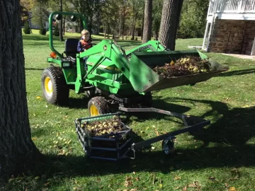

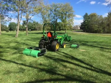

Also made a walnut harvester push frame, which now I’ll have to reconfigure for the newer tractor.
