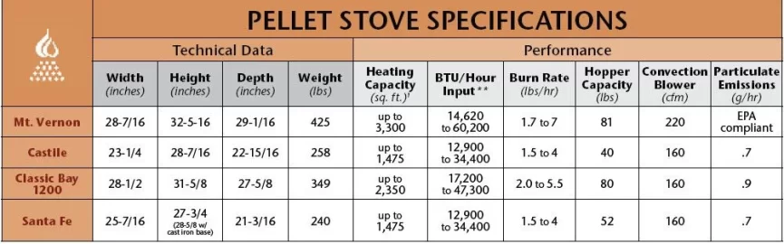

Have the CB 1200 free standing and love it. ....easy to clean and maintain .....here's the spec sheet on the quads....hope this helps especially on the BTU's..... cc ☺
  • [Hearth.com] Honest Opinion needed Enviro or Quadrafire?

I have a Sante Fe, and noway the hopper holds 52 pounds of pellets. You can barely squeeze one 40 pound bag in there.
