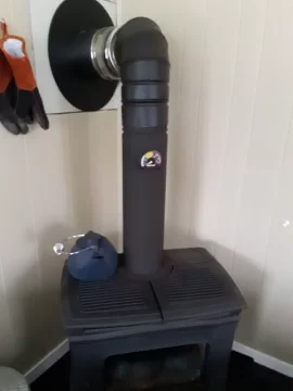

Stovepipe or stovetop thermometer? Where is it placed?

The thermometer is for single-wall stove pipe. This looks like Selkirk DSP double-wall stove pipe. It should have a probe thermometer. The surface thermometer can not provide an accurate reading of the flue gas temp. If the double-wall has been seeing 500º surface temps it means that the interior liner of the pipe has been very hot.
It is double wall stove pipe. Ok. What now? Pull the liner and have it checked for damage?
I would add a probe thermometer and I think you will find you need a key damper to reduce draft. The T4 is an easy breathing stove and 35 ft of liner is very tall. The probe thermometer will give you a much more realistic view of current operating temps. It will help illustrate the benefit of reducing draft by indicating a lower flue temp.
Less heat wasted up the flue = more heat in the house.
