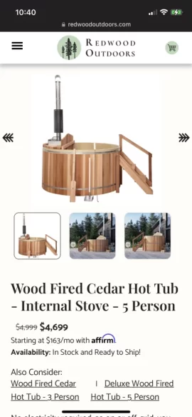

Hello
Just came across this wood fired hot tub. Takes about 1.5 hours to warm up!
Does anyone have one? Is it worth it?
Nice install video.
Looks like about $5k !!
(broken link removed to https://www.redwoodoutdoors.com/products/wood-fired-cedar-hot-tub-internal-stove-5-person/?sku=HT-INT-5L)
[Hearth.com] Hot tub with built in wood stove heater?
Snorkel tubs pop up every once and a while here. The value depends on the owner's personal time to keep it get it up to temp and keep it clean.
