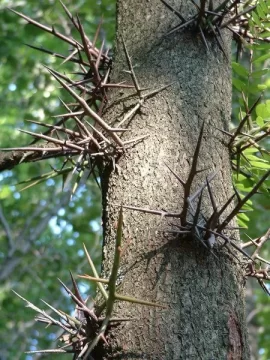

mo, here is a pic of a black locust. you EARN your money when you cut one of these up.
That's the tree we have around here that I've been calling Yellow Locust (or Honey Locust). If that's Black Locust, then my Texas Mesquite theory is toast.
not sure but i think the only differance between black and honey is the length of the thorns?
Dylan said:
Two TOTALLY different genera: Black locust is Robinia, and Honeylocust is Gleditsia.
http://plants.usda.gov/java/profile?symbol=GLTR for USDA's take on honeylocust.
Thanks for 'clearing up' that there is yet another Honey Locust. I guess binomial nomenclature has communicative value, even though miles outside lay conversation past, present, and future.
