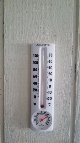

If I'm reading the numbers correctly the relative humidity is over 60%. At that level, I don't think I would benefit from more humidity.
This being said, I get the sense from reading discussions in other forums that the desirable humidity level for comfort is going to vary from person to person. I've seen wildly differing figures being given. What I do know is that the hygrometers I had around the house used to give me readings in the 45%-50% range. One week ago, I've bought a whole-house console humidifier and set it at 55%. This made a significant difference in my level of comfort. The one night it ran out of water, I knew right away when I woke up in the morning because I felt like I used to before we had the humidifier!

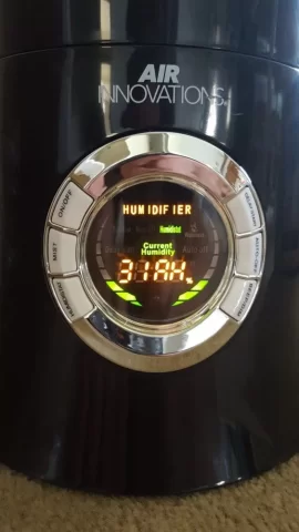

I'm not sure I trust that gauge. I went out and got a digital humidifier that gives you a relative humidity reading. It reads 33%. It sounds like I may have found my problem.
+2 on that. I bought two 2400sf consoles online on Amazon by Aircare brand and I use one on each house and it is a big different. I also have some weather station by Lacrosse that are more accurate than those hygrometer that you have. I have one of those at the house in town and never match the weather station and the console.
Can be possible you not getting an accurate reading out of that one.

After a few minutes plugged in the relative humidity now dropped to 31% . My whole body feels extremely dry. I think even a 10% difference would make a huge improvement. I'll let it run for a while and see what happens.
That's very dry and not very close to the 65℅ that the other hygrometer was reading! :)
I personally keep a calibrated hygrometer so I can tell how far off my other ones are. (You can do a reasonable 75% setpoint calibration on them at home using a plastic bag and some table salt.). You can get a digital one on amazon for under $20.

agree with zeno up above, those are just relative numbers on that device and have very little accuracy. if you want a somewhat more accurate number - invest in one of the more expensive indoor/outdoor Lacrosse units.
