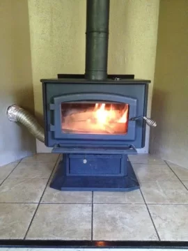

I haven't cleaned my glass in weeks. It stays VERY clear for some reason. Maybe the Drolet has a really well engineered glass wash system? This is after 3 weeks of burning. Mostly Oak and Ash @ 16-21% MC.
[Hearth.com] Houston we have a problem?  (Air leak?)
That's because u have a secondary burn stove and were talking about CAT stoves. CAT stoves burn at low temps with long burn times. Secondary stoves tend not to have quite as long burn times, but the firebox sure is pretty and the glad stays cleaner.
