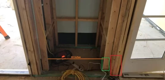

Thank you all for your replies. I have attached a picture of what we are working with. The big concern is the width between the studs - 33". I *think* the studs marked in green are not structural, but the ones in red are.
A mason I talked to said code is OK with 4 inches of firebrick lining the firebox. Do you all think he is right about that? The way I read it, code says 8 inches if you use 2 inches of firebrick...
The area to be heated is a 20 x 16 living room with a 10 foot ceiling. This is Houston, so we won't be relying on this year round (to say the least ;)).

That looks more like a closet than a fireplace enclosure. With the green inner framing removed there is enough room to install a good quality Zero Clearance fireplace that will do a much better job of heating while providing a nice fireview. The face can still be done in masonry for a traditional look.
Otherwise, it may take some surgery to make this work for a fireplace, like moving the left side supports over 6" and the doorway to the left too.

No 4" is absolutely not enough thickness. What is the house built on? If it is on slab is the slab thick enough to support the weight of a fireplace? If not on slab you will need to remove and restructure the floor then pour a footer and build a masonry supporting structure for the fireplace. Then pour the hearth and extension slab before even starting to build the firebox.
Honestly if you mason is claiming a fireplace can be built with just a single layer of firebrick it's time to find a new mason if you go this route
