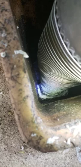

Hey guys. So I just got a stainless steel liner installed for my wood stove insert by a very reputable chimney sweep company in the area - they are certified.
Anyway, after they left I was cleaning up the insert as it was dusty and removed the trim around the unit. I peeked up there and saw raw stainless flue as far up as I could see before it elbowed into the damper area.
What I didn't see though is any insulation... No thermal wrap or wool material anywhere. No block off plate either which is disappointing.
The quote/contract I signed said it would be a stainless liner with insulation.
I can't see anything else from down here so I plan on going on the roof tomorrow. Can you guys tell me what to look for to confirm if this is insulated or not, before I go accusing them of ripping me off?

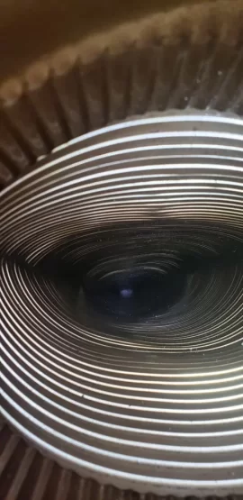

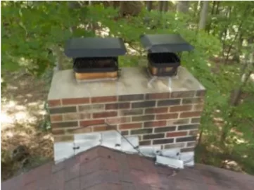

I attached a photo I took on my phone of the liner (they needed to bend it into an oval shape to fit through the damper area). I also attached what the cap looks like, on the left. How do I remove this cap to look in there?

Looks un-insulated to me...hold them to their contract!
I’m no chimney sweep, but it also looks bent and smushed all to crap. Looks like that would def restrict exhaust, and make it difficult to clean like that. Also pretty sure that crimped end (male end) is supposed to be inside the female end, not overtop of it, so creosote can run back into the stove. As for the cap, those screws are securing it, just unscrew them and it should loosen. Be careful not to crack the flue when u tighten them down again.
The guy that did mine wrapped it in insulation and then wrapped that in a wire mesh so it didn’t get torn up when he pulled it through.
Does not appear insulated. My insulation starts about 18 up the liner from my insert . Also concerning is that the liner does not appear to go all the way up to top of chimney. This will present you with a big challenge with sweeping the liner, as you’d have to remove the insert to do that to get all the soot out.- they are very heavy. Installing liner in that way in no way is best practice.
i was in your shoes before with a crappy insert install. I decided to have it redone by another pro. It’s painful to open the wallet again but I needed to sleep at night. I decided at that time to have installer break outout the old clay liners so new liner could remain round all the way to top of chimney. I also opted for heavy wall liner. The installer asked why- probably doesn’t get that request often. While regular liners are ok, if you ever have the chance to feel thedifference between the two, you realize that heavy wall is a better bet.This second company also insulated the liner.
Id hold this company accountable. They will likely balk at any requests you make. If you’re hitting a wall with them, you might remind them that you have the a ability to share your experiences in online reviews and the like and that you have time on your hands to do so.
Does the liner even go to the top?
Good point...if it does, it has some sort of hack termination! (if the chimney top pics are from after the install)
Also, the way the stove adapter is installed is backwards, as was mentioned...I would not light a fire in this thing until things are fixed! (is the adapter stainless steel? It should be...almost looks like it could be galvanized ductwork adapters...it should be stainless STOVE PIPE adapters! Duct is much thinner...and the galvanized coating has poisonous off-gassing when heated over a certain temp...which is much lower than wood stove exhaust!)
Hey all thanks for the responses! Sorry should have added that the chimney cap photo is from before install. I haven't been up there yet to inspect the work. They reused my current cap.

Looks uninsulated to me and looks like they did a hack job ovalizing it. Go up and pull the top plate that will tell us allot.

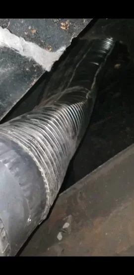

Well just got off the roof, here's my update.
There is insulation, but it's about 1-2 feet down so I can't reach or it see how much is there. Also, there is no top plate... I was able to move the liner back and forth! Very disappointing.
How do I approach the company on this? I appreciate the help.

To my untrained eye, the insulation seems like it’s loosely “attached” to liner.

That's not an insulated liner...that is a shoddy way of kinda sorta sealing the gap up between the liner and the chimney flue...since that would be a major air leak...but the right way to do it is a blockoff plate on the ceiling of the old fireplace opening, made to fit snug around the liner....and the whole liner needs to be wrapped with an insulation blanket made for this purpose, what is there now does nothing to insulate the liner from cold air, or the existing chimney flue.
And that liner needs to be hung from a top plate...using the correct parts! The top plate is what is supposed to support the whole thing...not the stove! That is one of the most unprofessional installs I have seen on here in a while! I'd make them redo it properly (what you paid for) or they can deal with my lawyer, their choice!

They also need to install a properly ovalized liner. That liner was obviously just crushed by hand. That leads to the kinks and creases you see which can easily lead to early failure or separation. If they don't have an ovalizer they can order an oval liner

The pic you had above showed very little insulation material. Whatever they initially did was hack. The standard would be to wrap the length of the liner itself in special designed foil faced insulation (1/2 inch thick). They then should put over that a special wire mesh over that. Here is a video on it. I’d demand that whoever installs your new liner do it this way.
