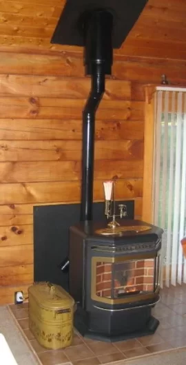

Not to say it can't be done, because it can, but i don't know if there is an adapter made to go to 7" pipe. There are adapters to go from 3" or 4" up to 6" and 8", but I never saw one for 7". But that is just Simpson pipe I'm referring to....maybe another brand has the adapters for 7".
I went from 4" to 8" on my old wood stove pipe, so it can be done:
Oh, and I just remembered....my stove pipe is double wall.
  • [Hearth.com] How Do I Connect a 3" Pellet Flue to An Existing 7" pipe?
