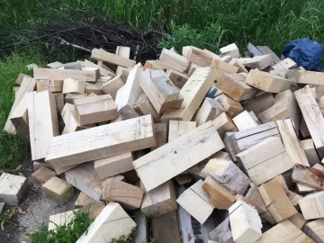

OK, I get the stuff from the local pallet manufacturing company. They are about 4 x 8 blocks of wood, of various lengths.
I plan to get a lot of it in the next month.
I need to season it, but I'm not sure how to stack them. Or if I should just pile them up.
Anyone out there with experience can give me some advice on the best way to season this?

I would check with the people making the pallets
If they make for international transport of good they have to be kiln dried and
heat treated to kill any bugs no seasoning necessary
I'd just throw them on pallets, top cover to keep rain off
That way air can flow through loose pile
They are definitely not Kiln dried. I split a couple and they are over 40% moisture content.
I am thinking to just stack them on pallets and let them dry. If I stack them fairly loose would that work?
Or could I just leave them in big piles? It seems like they are drying OK just as they are... but I don't want to find out this winter that I was wrong.
Sent from my iPhone using Tapatalk Pro
If left in a pile the top portion would dry, but the stuff lower down wouldn't. I would loosely cross/crib stack them on a pallet leaving a little space between the pieces for airflow and throw a trap on the top.

Build some five sided boxes out of pallets (bottom and 4 sides). Put them where there is sun and air circulation. Throw the blocks randomly in there and repeat multiple times leave some space between boxes. Put a pallet on top and cover the top of the pallet to prevent rain from coming in but air to leave the top. They will dry fairly quickly as the bark is off and they are short.
Yes, I would just stack them up with a small gap between blocks to allow for some airflow between them. Or make a large covered bin with a pallet base that you can toss them into and let dry.
Reactions: larryjbjr
That sounds like a good idea.
peakbagger has a good idea use a crate and throw wood in a jumble.
Another option is to sticker each row using 1/2" - 1" thick sawmill scrap trimmings. This is similar to stickering fresh cut lumber to permit it to air dry.
If it's stackable and fairly consistent I would stack it normal except I would put a row of tomato stakes on top of each stack to act like a spacer
An easier option is if you can find then, IBC totes used to ship liquids have a light weight metal cage to protect the plastic tank. If you could find some of them without the tank they would be perfect for wood drying.
I'd criss cross / log cabin stack with the 8" oriented north / south
Sent from my SM-G930V using Tapatalk
If you are planning on burning this winter, then +1 on stacking on pallets, crisscrossed stacked, & top covered in an area that gets plenty of wind and sun. That will be your best option. If you can split the larger pieces smaller, that help drying the wood out.
Do you know what kind of wood it is? If it is pine or soft maple, it should be ok by winter, but if it is oak or other hardwoods, it may not be burnable this year.
Might want to cover with black tarps or plastic to make more of a solar kiln effect maybe?

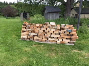

I ended up stacking it like this. This is one load, so now that I have it stacked I guess it's not quite a face cord. Still not bad for $20 though...

Great job... your hard work will be rewarded come winter.. i would top cover to keep the rain off..it will dry pretty quick that way...
