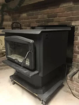

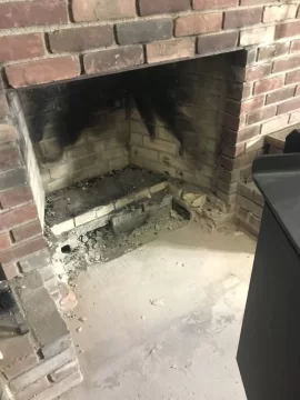

Are you planning on sticking the stove inside the fireplace?

Yeah , pretty tight fit.
Doing that is really going to hurt the heatoutput of the stove. The heat radiated off the stove will just go into that masonry structure. Is it on an outside wall?
I realize that and this is why i'm trying to remove as much brick from inside of the chimney to make room for liner and not to shove the stove all the way. The good thing, this is not outside wall, but its basement with uninsulated floor, so lot of heat will be lost. Hopefully blower will help. it will be supplemental part time heater. Didn't really need it but couldn't pass $600 deal for almost new stove. Previous owner said he is going back to old stove, because this one not producing enough heat. I guess he needed to dry his wood somewhat more . :)

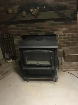

I'm having trouble with determining if this wood mantel can be above the stove.

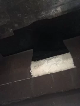

Looks like you notched the lintel to get the flue collar to fit under. Was there steel flat stock under the bricks, across the top of the fireplace opening? What did you do about that? I'm wondering since I need a little more lintel height if I want to fit a different stove....
Looks like they don't have mantel clearance requirements listed, since it's a free-standing stove. Here are the insert requirements. I don't know if they would be safe for the free-standing version...

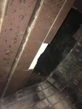

Thanks , didn't think about checking inserts specs . Actually , I didn't remove this plate . I had to get rid of bottom brick part if insert to make it fit. O cut opening in smoke shelf , though. Going to try to remove some brick from actual chimney to make space for liner.
