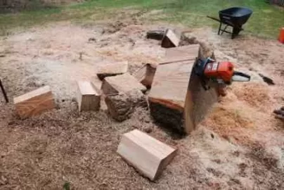

Unless you have an ATV, tractor or skidder, logs are usually too large to mess with. For that reason I have been cutting to firewood length and cutting rounds to a size that I can haul the wood out with. When I was at my ex's and burning in her OWB, firewood length meant 2-3 ft long and no splitting anything under a foot in diameter. Those things take large rounds and large noodled wood. Now I have a large wood stove, so its 16-18 inch lengths. When I am falling trees I buck them to length and noodle them into liftable sizes and into the truck they go. If I am cleaning up a tree service job I buck any longer logs and noodle the rounds to a manageable size. Once home, I split the noodled rounds with a maul into fireplace splits and stack them for drying. No special apparatus for me, but the rounds/sections that do not split (like burl or knot wood) I noodle smaller with a chainsaw. I use a flat block of wood on the ground for splitting with the maul or noodling with the chainsaw.
Noodle cutting: using a chainsaw to cut large bucked wood rounds with the grain into halves, quarters, 6-way, 9-way, or lately 12-way sections. The parallel wood chips look like noodles, or curly French fries. Its the easiest way to cut with standard chainsaw chain.
Here is a photo of the last of many 4-6 foot diameter Doug fir rounds being noodled into manageable blocks for splitting later. That's my 044 with a 25 inch bar buried in it.

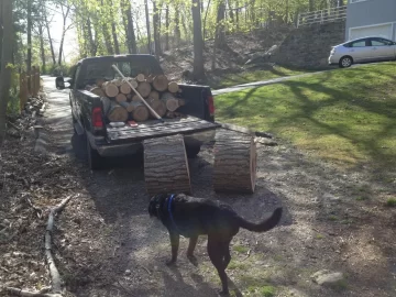

I cut all but the smallest stuff to length and usually have to half or quarter to get it on the truck. Being a suburban scrounger, most of the wood I get is large, storm damaged Oak or Black Locust. The rounds are often way to big to manage and an 8 footer would require a crane!
