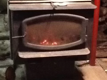

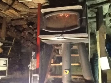

here are a couple pics. I can't seem to get the one pic to rotate. computing is not my strong point. I know, boring with no fire, but I am wooped and ready for bed so I am burning the coals down to load it up for the night. I think I am gonna make tomorrow a slow day for me. let the boys work a little harder. lol
You have a draft problem, stoves supposed to go on the bottom.
